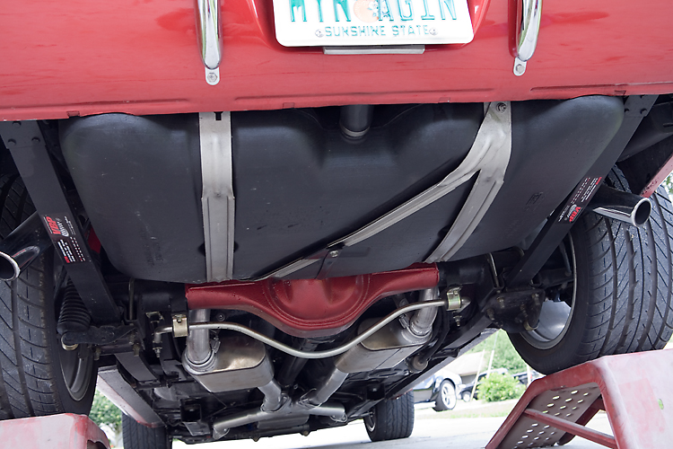

We wrapped up our 69 Camaro LS1 project in mid 05 and have enjoyed the heck out of it. She blows ice cold a/c, runs 12.5 in the quarter, and gets mid 20s on the highway. You can't beat it. However, I did things VERY different than the average Joe...so if you like here is a break down.
Specs - 2000 LS1 and 4L60E trans
Brewers motor and trans mount - no drive shaft cut needed.
Stock F body accessories - work great and are very reliable (cheap too)
2000 Z28 Pace Setter non-emission headers (three pipes modified on the driver side)
TCI stall
Bowtie overdrive four speed shifter and console plate
I picked up the block for $400 with a spun main. A $160 crank kit, new rings, gaskets and seals...she was ready to go back together. A roll master chain, then all topped off with a Stage III SLP head/cam package - 36# injectors - LS6 intake - stock throttle body. The head/cam was not a budget item..but I couldnt resist.
Trans was $100 from a trans shop with a blown reverse. I rebuild kit and a few hours later and she was rocking and rolling - with a Transgo Kit added later. Under $400 in the trans.
I had the sub frame out of the car and took measurements of the a/c compressor and performed a simple notch to clear the a/c.
Fuel lines and tank came from a 96 Caprice (22 gal capacity). After a bit of work, it slipped right in and connected on a set of 97-98 Vette rails. This was a direct snap to fit with no cheesy adapters.
Ran a 98 PCM with a mail order tune from a non-site sponsor ($75).
Cooling fans came from a later model Malibu for free, as they were in a collision and the edge of the plastic was broken. Body shop was throwing it out.
Radiator is a Griffin knock off aluminum for $120.

The Caprice tank is interesting, how did you know it would fit? Could that diagonal bar be removed for better cosmetics? 22 gallons is a bonus for Power Tour.

I took a guess on the tank. I had a 96 caprice cop car for parts and realized the fuel filler sticks out the same spot as the Camaro. I cut the floor from the caprice and made a removable door to access the pump so the tank wouldn't have to be dropped. The black additional brace could be removed - but I feel safer with it there making sure the tank is not going to get into the diff. That is actually part of the stock Camaro tank strap I re-used in conjunction with the caprice straps. Oh...I think if they were all painted satin black, you wouldn't notice. You can also put tire-shine on the tank - since it is plastic and make it glow down there. You can't minitub the car with this mod however unless you run coil overs. I was able to drop a Walbro 255 pump straight in the stock Caprice mount.
I've walked a few other guys through it. It is by no means a "bolt in" - but if you like a challenge and the trick results...why spend $1K on a custom tank?
We drove the car to Goodguys in columbus Ohio and could run just over 400 miles between stops - not getting in the throttle.
The color is actually 1986 Renault Alliance (remember those little cars?) Med - mica red. The stripes are Cadillac black cherry with gold accent. It has a pearl accent without the expense or hassle of real pearl.
Total cost to put the LS1 in and get it running (not paint/body -etc) was right around $4K - with a fully rebuild (less the same pistons) motor.
The car also has cruise control which is hidden on the column under the dash and uses a stock GM column switch. That helps on the MPG. I also wired the wipers into the column and used the spot on the dash to mount the fuel pressure sensor.
By the way, I believe a pre plastic Caprice tank would work too, and might be easy to modify...etc. because you can weld -etc. Like a 1987-1990, as you can use the fuel pump assembly and sending unit.

The caprice tank does fit in a 2nd gen. I am just sorting out the installation of mine.
